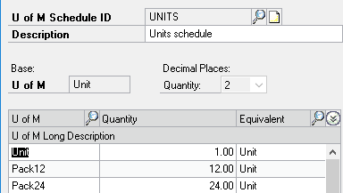

    Hi Elizabeth,
    typically, you should have a Unit of Measure schedule such as "Eaches" or "Units" which will contain your different units of measures and their conversion factors.
    E.G. :
    UOM schedule example
    Be careful not to entitle you case of 12 units just "Case" since this schedule is generic, and can then be used for other items in your system.
    Otherwise, you could name the UOM Schedule in a specific name for usage for your item, such as "UNITS_OF_A", then you could use "Case" in the U of M.
    I prefer to go generic, naming my UOM with the number of units in it, but this is up to you.
    Using the Schedules correctly will let you receive in a different UofM included in your schedule, and stock take in another UofM.  Stock will be kept, in GP, under the base UofM, which should be the smallest denominator.

    Elizabeth is correct that you cannot change the UoM for the POP Receipt when  matching to the PO. Thus if the PO  UofM was done as CASE12 and the QTY is 2 she can only receive 1 or 2 cases not 1.5 and she cannot change the UofM to Eaches on the Receipt as the PO was CASE12.
    The solution to partial receive is to set the Item Quantity Decimals to 2 instead of the typical 0 and then set the purchasing option to allow fractionals on the CASE12
    See the screenshot below. That setup will then allow fractional receiving of the CASE12. I would not allow fractionals on the Base UofM but it is allowed.

    Thanks for the info Thadeus !
    I was on the impression we can receive in a different unit of measure.  But since I have 2 decimal places for the quantity, it is probably the reason why my users never complained ;)
