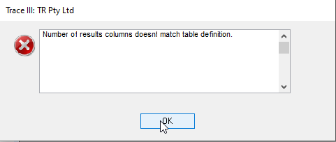

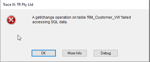

    However, one database (the biggest and most heavily used) is not working.  When I try to access the view using a simple form, I get the following error:
    Now, as I said, every database is identical (schema wise).  I have copied the same dictionary to every location and dropped and recreated the view in every database, but I am still getting this error.
    I need to have this resolved before Christmas so I am getting desperate.
    Does anyone have any ideas what might be causing the issue.
    The view name and table definition are identical across all databases.

    Problem resolved.  I discovered that when I recreated the stored procedures for the view, they didn't actually change for one database.
    I did that using a program within our application to drop and recreate the procedures and ran the same program against each database.
    Not sure why that happened but now it is found, I can upgrade that installation to the latest version of our software.
