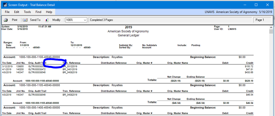

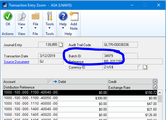

    Is there an easy way to add the Batch ID field to the Detail Trial Balance report in Report Writer?
    I can't find the field/table.
    We are using Dynamics GP 2016.
    Thank you in advance.
    Batch ID Field
    Trial Balance Report

    Hi Lynne,
    Based on my testing, you might be looking for the Originating Source field from the Year-to-Date Transaction Open table?
    (screenshots below)

    Thank you! That worked.
