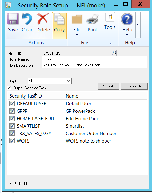

    Hi Jason,
    I created a security role just for smartlist for users because we have both smartlistbuilder and smartlistdesigner installed and I didn't want some users to have access to those.

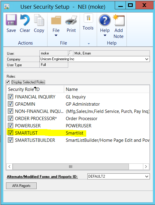

  • 3.  RE: Smartlist Permissions for a new GP admin
    Posted Jul 05, 2016 12:40 PM
    If Smarlist permission is already set up, you need to select the user and assign the permission under User Security Setup. Select the User and assign the smartlist permission.
