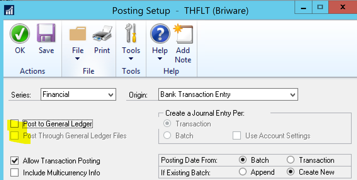

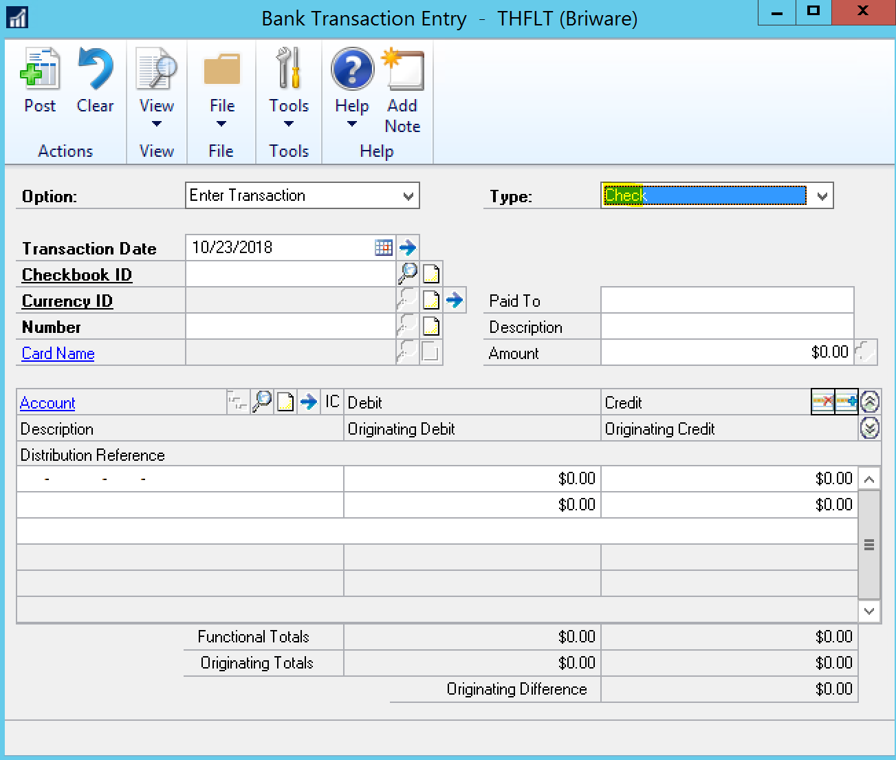

    You will want to enter them in as a bank transaction type: check.
    Basically what you will do is enter them into the Sub Ledger without hitting the GL since you've probably already entered in your beginning balances for your balance sheet accounts which includes your checkbook.
    1.  Verify posting setup is turned off.  Microsoft Dynamics GP > Tools > Setup > Posting > Posting
         - Series Financial and Origin Bank Transaction Entry
         - Uncheck the Post to GL and Post Through General Ledger Files if they are checked.  Make note of which one was checked for #3 below.
    2.  Enter the outstanding checks into the Bank Transaction Entry window.
    3.  Go back into the Posting setup window and check the Post to General Ledger and Post Through General Ledger Files if it was checked before.
    4.  All done.  Verify that the entries weren't posted to the GL by looking at the account summary for your bank account GL.  Also verify by looking at the Checkbook Register that the outstanding checks are there.
