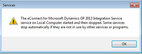

I was recently performing an eConnect installation as part of a eOne SmartConnect installation. The installation went as it should, but the service did not start after installation. Starting the service manually yielded this error:
The Event Viewer shows the following:
Unable to bind to the underlying transport for [::]:80. The IP Listen-Only list may contain a reference to an interface which may not exist on this machine. The data field contains the error number.
The eConnect for Microsoft Dynamics GP 2013 Integration Service service is marked as an interactive service. However, the system is configured to not allow interactive services. This service may not function properly.
Service cannot be started. The handle is invalid

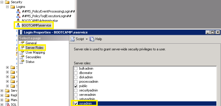

2. I verified the eConnect User is setup in SQL and has sysadmin privileges, using SQL Server Management Studio.
Here's a screenshot of how to check for this. Log in to the SQL Server > Expand Security > Right click on the eConnect user > Click Properties > In the Properties window click Server Roles. Ensure sysadmin role is checked. After granting sysadmin privileges, try starting the service.
